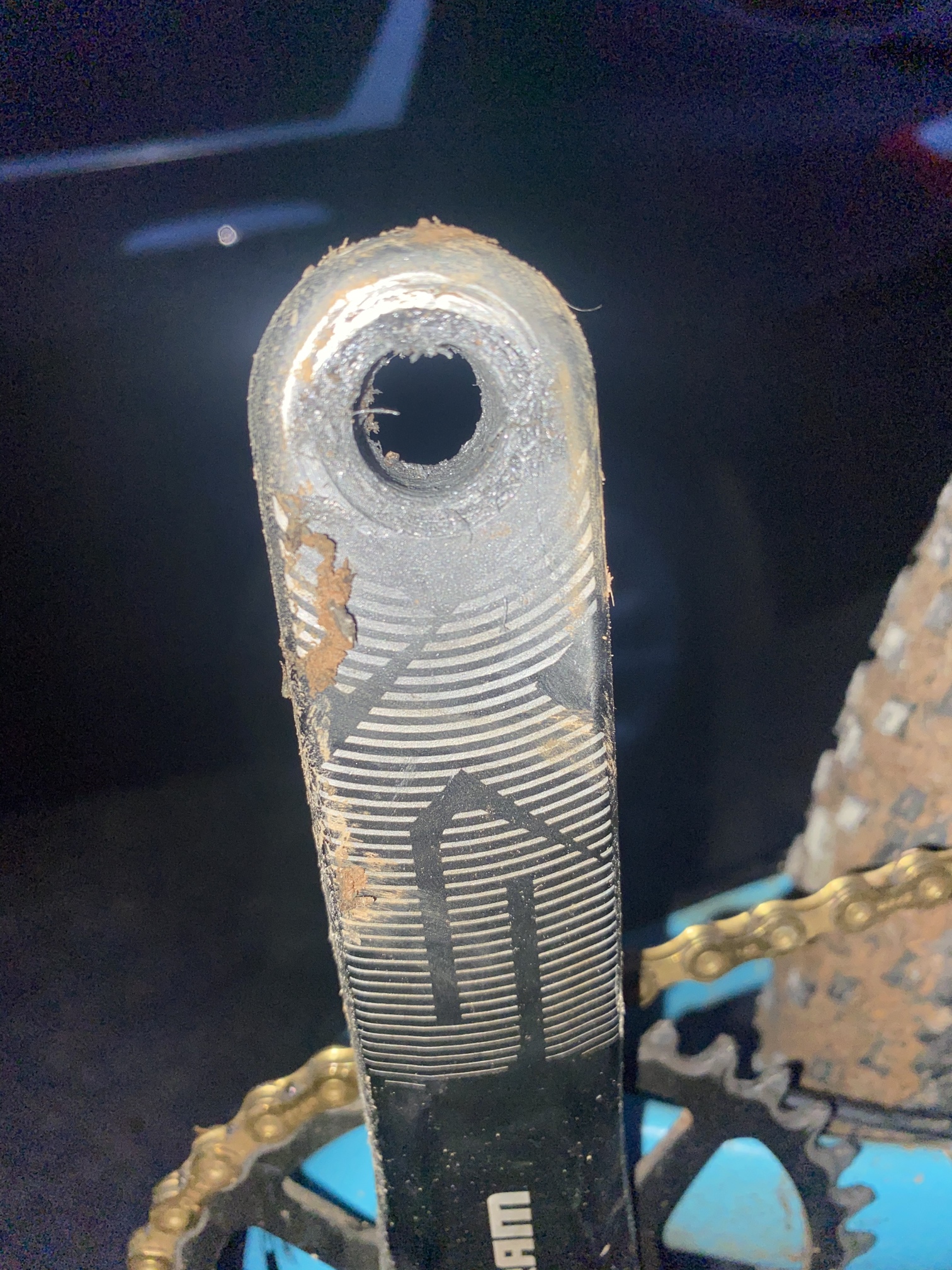

I find it hard to believe you could have put them on the wrong side, it wouldn’t be very easy to do
Might have crossthreaded them.
Helicoils work in a pinch but they aren’t permanent/reliable with the rocks we bang into around here. Cyclesmith used to stock them and do insertions for those who asked. Maybe it isn’t a thing anymore . Lots of truvativ hussefelts got them because the threads were actually winding out of them new.
God Hussefelts were awful.

The pedal is steel, the crank is aluminum. Pedal is still in perfect shape, if I retapped the crank I would need a different set of pedals with a bigger thread. I haven’t removed the left side pedal to see what shape the threads are in so I’m not sure. If I installed them on the proper side, I don’t see how it would’ve loosened off. They were put on quite snug
pic of pedal?
Helicoils have a large enough outside diameter to fill most stripped cranks. You don’t retap the pedal, you thread a new one in and loctite it in place.
Don’t have one, but the pedal is still in perfect condition.
i have a helicoil on my rear brake mount on the shinobi working great for several months now, thats a pretty big hole in comparison and goes straight through so no bottom out but i cant see why it wouldn’t work if installed correctly as your tapping a larger thread and threading the coil onto it (loctite the hell out of the coil)
Ahh, that is not what I got from the original posts, I would say the helicoil suggestion is the only possilbe fix for that aside of welding in more material and re-tapping it, both of those options unless you can do it yourself will probably cost as much or more then new cranks.
I did a quick google search and these guys have SX in stock (165mm though) SRAM SX Eagle Crankset - Sweet Pete's Bike Shop Toronto
Bottom Brackets are not really that much money, I would assume shops in the city would have other crank options if you swap out the BB
