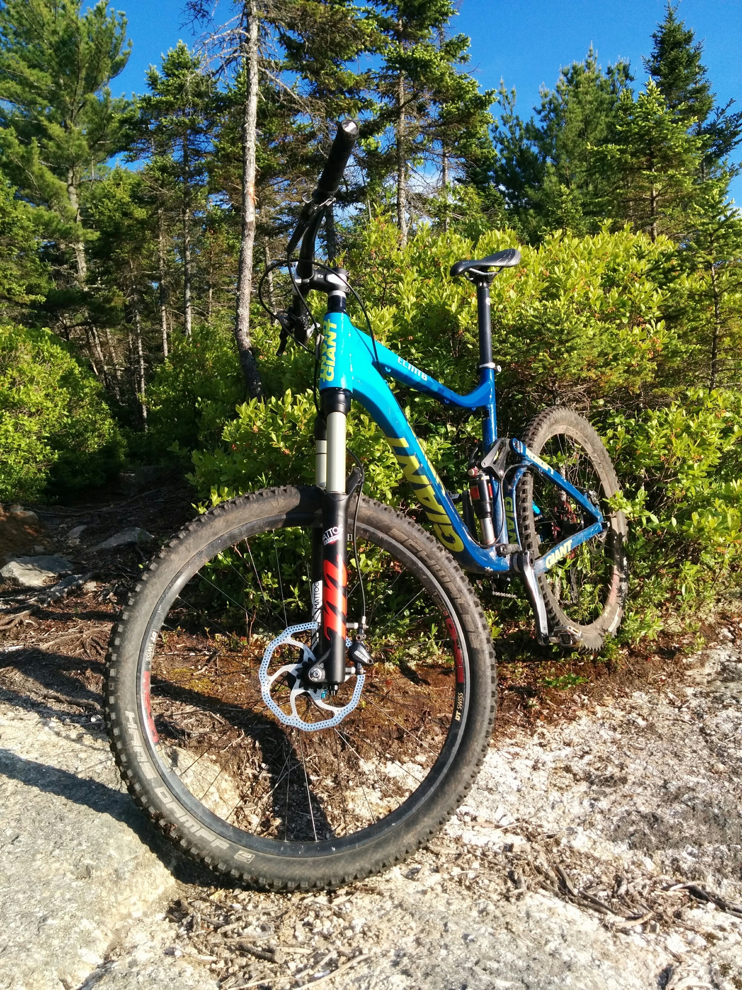

Christmas in June! I’ve been riding this Pike since spring and I’m still tinkering with the set up. Seems everyone online has a different opinion. I was going to set it up as a 150mm but decided to ride it at 160mm for awhile. It seems fine the way it is. When I set it up to sag, i originally used the suggested pressures for my weight, I ended up draining a lot of air and am really enjoying the results. I’m sure I’m not going to be the only one curious about how this fork works out for you.
Looking at the sticker on the fork, it came configured as 160mm so I’m going to leave it.
The fork is really smooth, I can’t wait to give it a go but have some front brake caliper spacer issues to sort out.
Wow what fun! Smooth as silk, stiff where it needs to be and yet not noticeably heavier than my Revelation.
That’s about as good as any review I’ve ever read.
