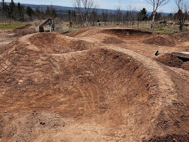

Yup! We built the Pumptopia design from Lee MacCormack in our backyard in 2021. It’s about 30m x 20m. We spend quite a bit of time each spring refreshing and revising it, and then it’s good to ride the rest of the season, until the end of October at least. I love it. Would love to chat if you’re still thinking about building one.
oh man, that looks awesome! wish I had the space for that. Curious to know if you did any landscaping or grass around and any special drainage techniques or difficulties you had for wet weather
Thanks! A smaller one would still be great - lots of benefits to having one in your backyard.
We didn’t do anything for landscaping, just left it all as dirt. I like riding on that better than grass for entry/exit, and not much grows in the clay anyways haha.
For drainage, we just guided everything out in the same direction through three channels. It can handle a lot of water - I’ve seen rivers running off it - and it still dries pretty quickly for riding. We also put a ditch around the outside on the upslope to divert runoff away from it.
The only issue is that some dirt gets pulled down from the top area where we cut into the bank, and it settles between the rollers. Every few weeks we spend maybe half an hour cleaning that out, so not a big deal but I would like to figure out a solution for that.
