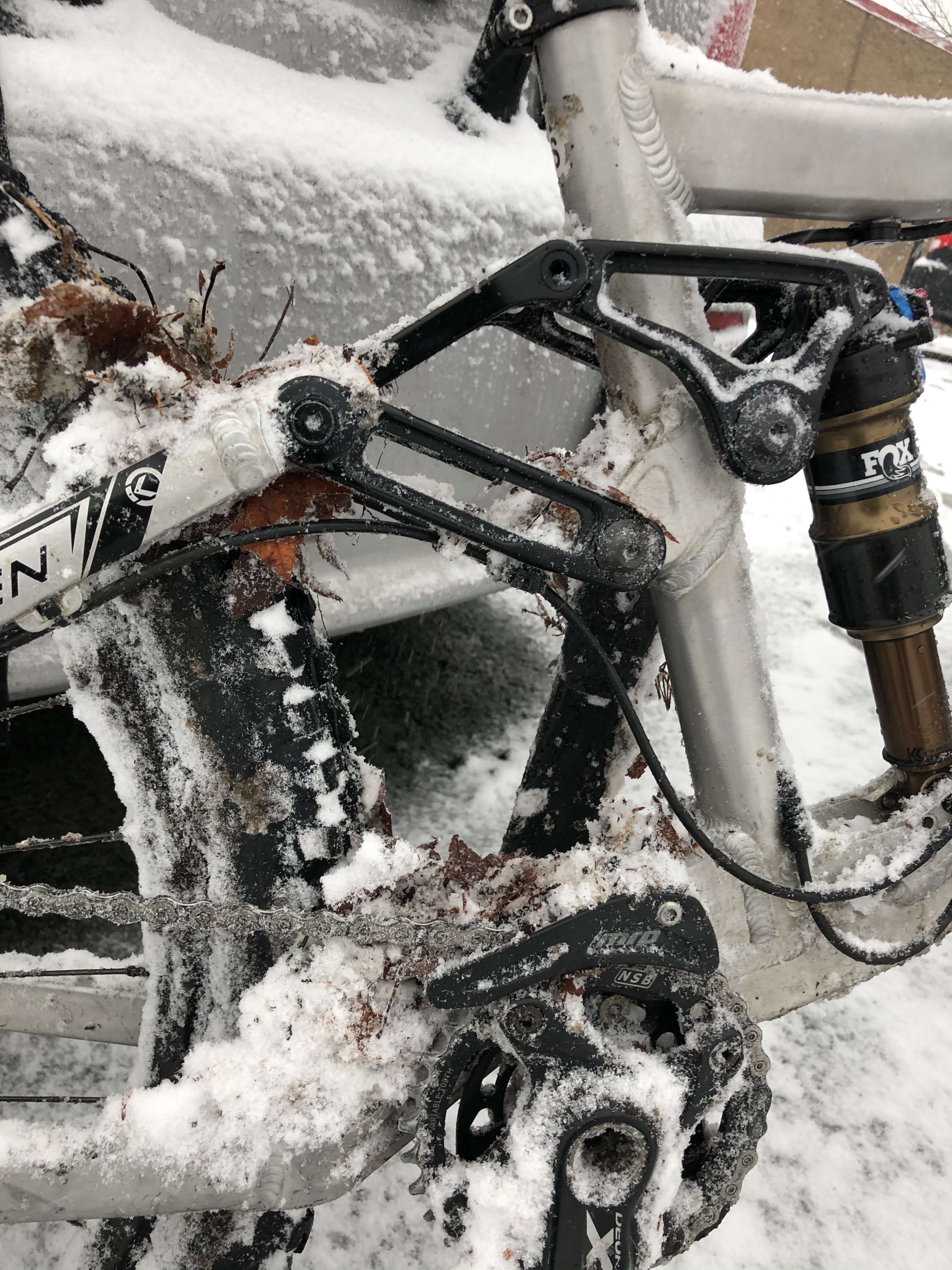

I run a Blackspire TrailX on my dually, mostly for the taco bashy, I remove the top guide for regular trail rides and but put the top guide on if I go to Keppoch or somewhere with lots of sustained downhill.
