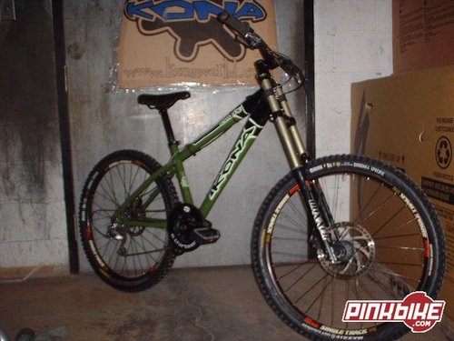

My 2005 Big Hit that I sold last summer was a bit of a frankenbike. It had 8.1in of travel in the rear but I put 6in travel fork (Jr. T). The fork was a good deal and I didn’t really want to spend a lot of money on this old bike anyway. The frame only accepted a 24in rear wheel so it was technically a mullet as well. Oh and it weighed 39lbs.
On paper it should “ride like crap” compared to modern bikes but it was definitely still fun to ride. I had a blast at Keppoch with it last summer. I sold it because I didn’t really use it. I figure my Reign can handle most trails around here and the occasional trip to Keppoch.
