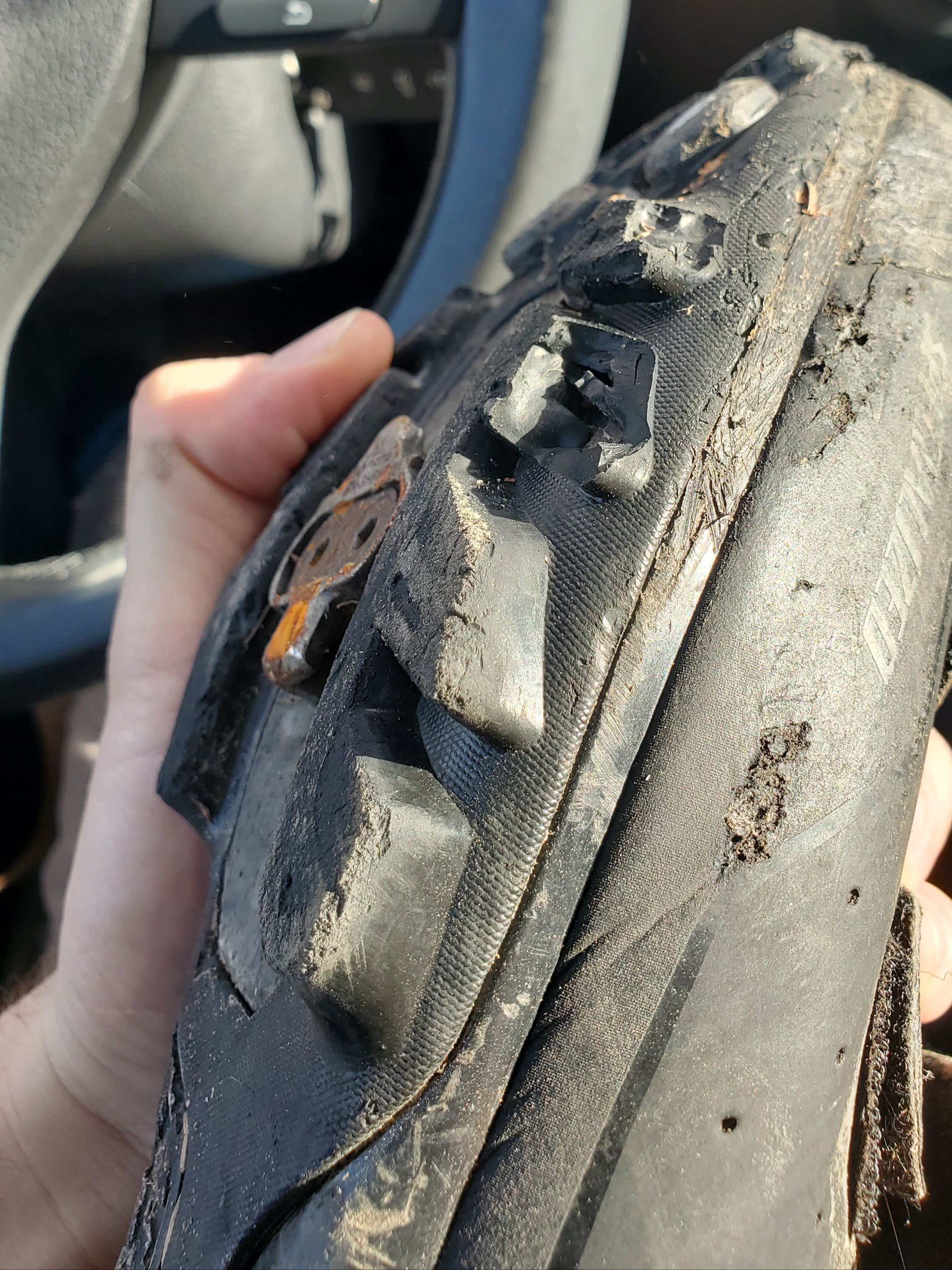

True story. I’ve managed to tear two lugs off one of my my MTB shoes so far this year. I gave up on CrankBros pedals after bending the spindles on three different pairs, so it’s all SPD all the time now.
Wow, that’s crazy. Jumping?
Bent the first two pairs riding a fixed gear around Montreal and Calgary, and the last pair riding trails on PEI.
As far as the shoe lugs go, that can be blamed on the granite at McIntosh Run.
