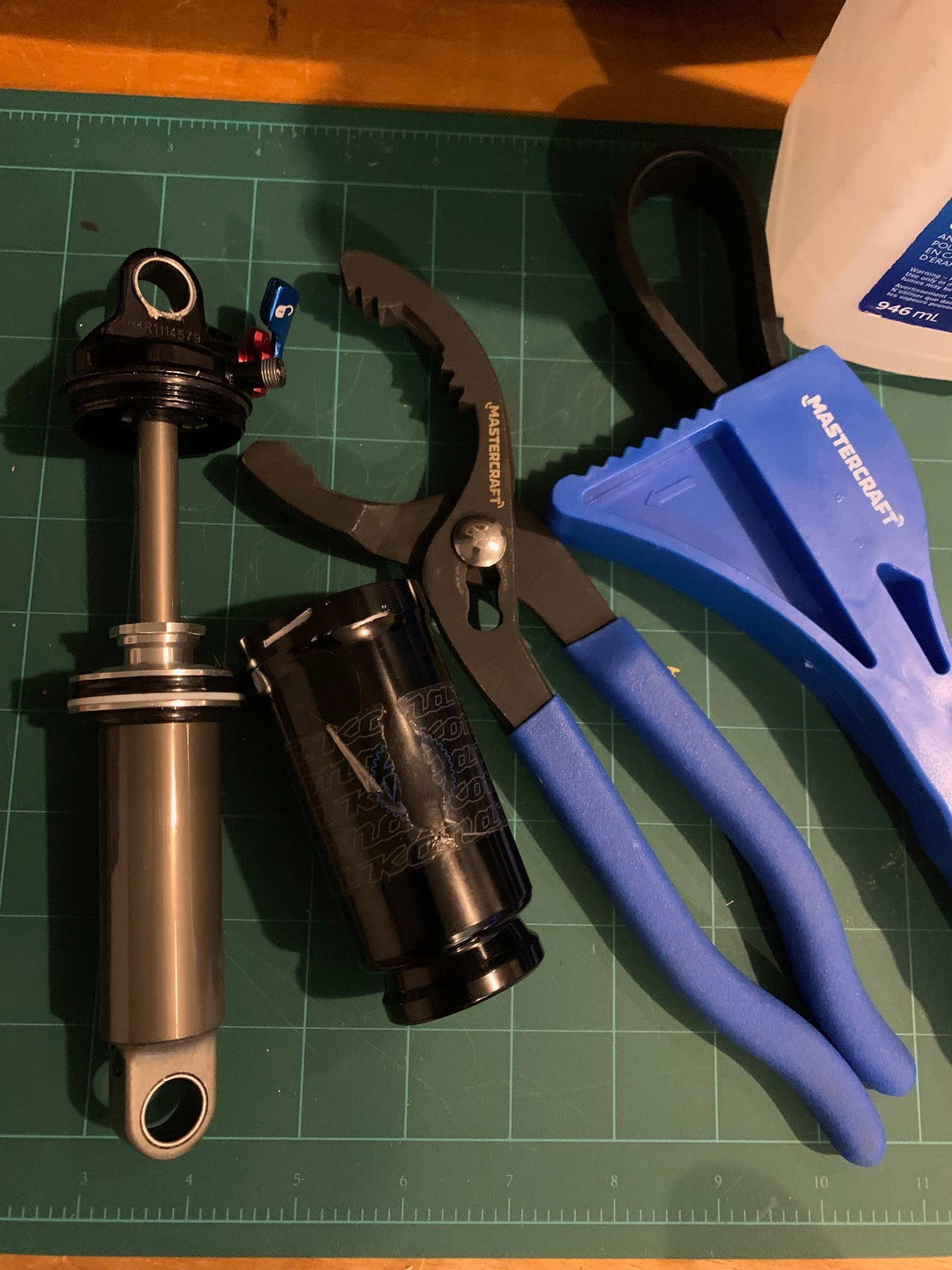

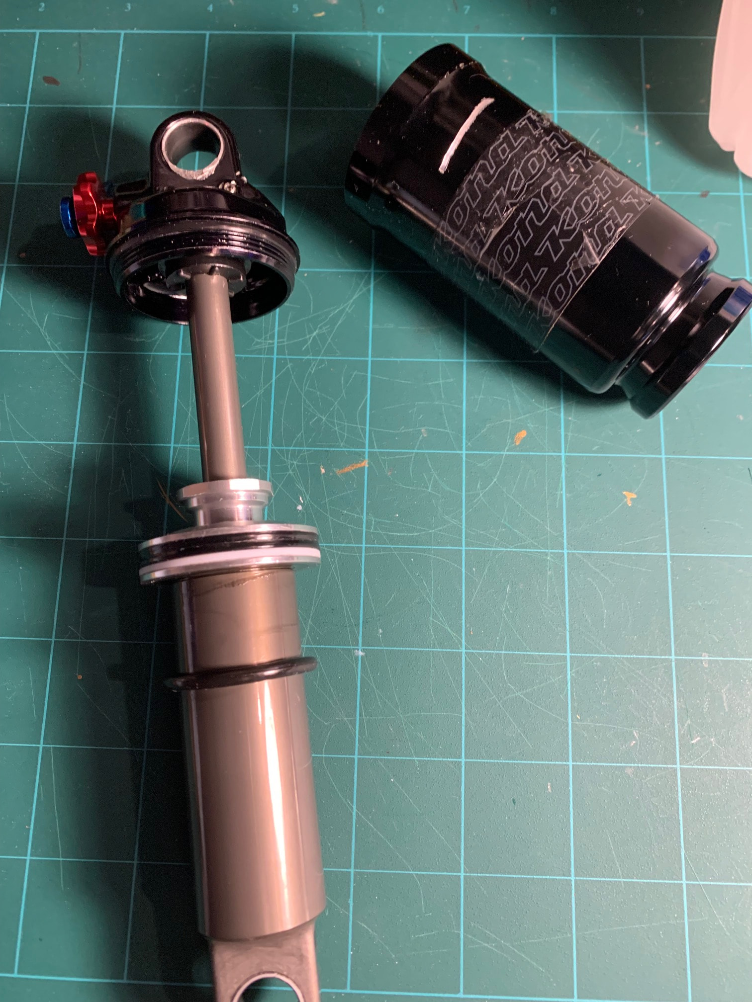

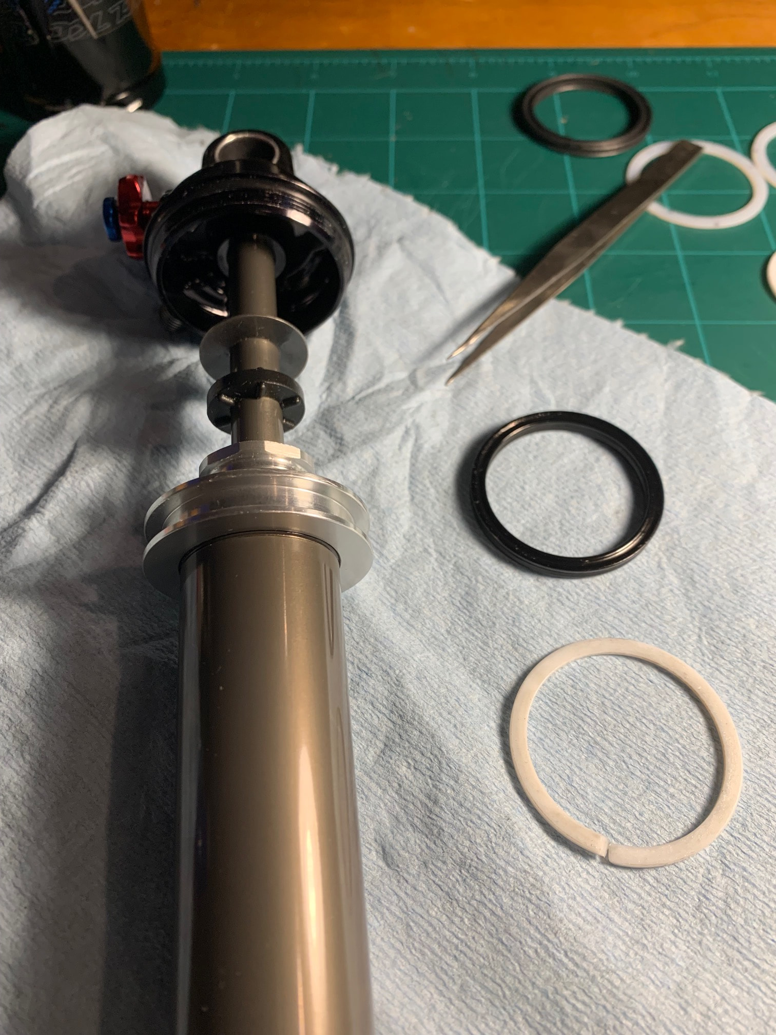

Well I took the plunge to try and service the Kona shock. It was stubborn as hell to get the air can off but finally was able to remove it after a couple of attempts. I did scratch up the can as it took some force to get it off. Not a lot of seals and dust wipers in there but bought a Fox Float kit to see if I could use any of those parts. Unfortunately I didn’t find any that exactly matched the internal ones (some were very close just a little smaller) so I just cleaned everything up really well, removed and lubed up the old seals and rings with Slick honey and added a small amount of Fox float fluid into the can. I tested on a quick ride and all seams ok but still feels a little mushy even at 150 PSI. I’ll try adding more air when I get a chance and test again. I’ll keep the shock locked out but there is still a little play. In the meantime I’ll still be on the lookout for a replacement.

As mentioned, that shock would have been made for Kona most likely by SR Suntour. There is a very high chance that it has lost its nitrogen charge over the past 16 years which would explain it being squishy. That shock would be nitrogen charged to 350-500psi, so I don’t recommend opening that up unless you have experience. I can rebuild it and probably have part in stock, but if you were hoping to buy a replacement shock for less than $200 a damper rebuild is probably of not interest as that too is around $200 parts and labour.
And just a PSA, but riding it locked out on anything more than pavement or gravel will end up causing issues. If you are trail riding it and the lockout plate keeps getting hammered by the oil something will eventually fail, and that won’t be repairable on that shock.
