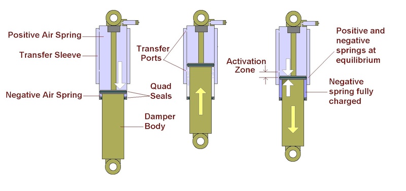

I would refill and do a short ride again. If you didn’t cycle the shock while adding air initially the negative spring air chamber may not have gotten completely filled to the same PSI and when you rode the movement allowed the air pressure to equalize between the positive and negative air chambers via the transfer ports lowering the overall PSI slightly.
