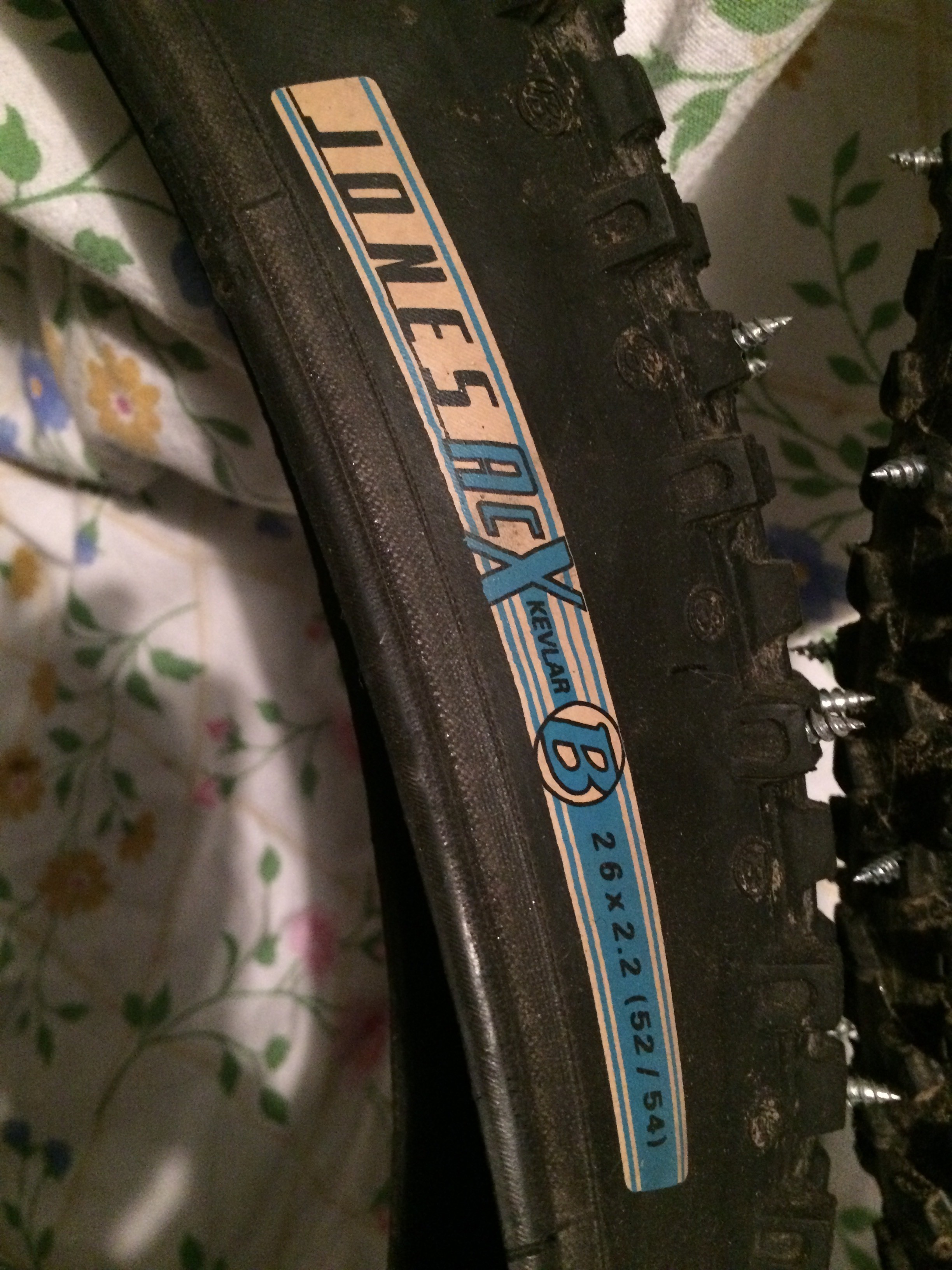

a lot of guys on here have made a set. Much less expensive. I made a pair of 26" using wood screws. Like velcro on ice
The most cost effective option is to make a set yourself. My first studded tires were a DIY project. It’s time consuming but pretty easy to do. All-in I think it cost me under $80 which included 2 brand new Kenda tires.

I only skimmed the video, but looks to be essentially what I did for the two sets that I have made with a couple exceptions;
-I drilled a small hole with a drill from the outside-in, rather than force something sharp thru.
-To speed things up, I carefully used my battery powered impact to drive the screws in rather than a screw driver.
-I used an old road tire with the beads cut off to line my current set of tires. Simply using an old tube as a liner seems interesting. I’d be a little concerned it wouldn’t be tough enough though.
I use a strip of old seatbelt for a liner. Tough as hell
That’s essentially what I did with the first set I made. I didn’t have a seat belt to use, but I had strips of fairly thick canvas. It didn’t make for a light setup, but I never flatted!

Here is couple of pics of the ones I made
