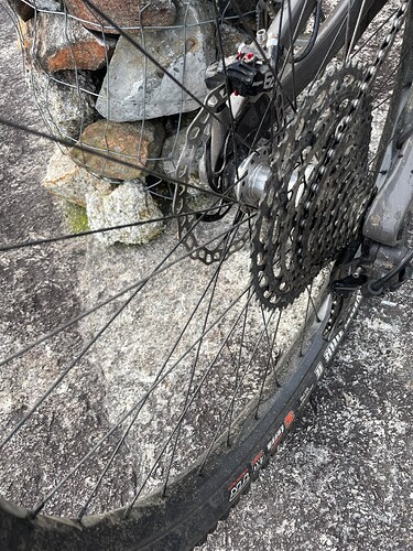

My 2020 Giant Trance 29 came with carbon wheels and I really love how they accelerate and roll. I’m only 70kilos and am a pretty light rider but I had some problems with them. First a loose derailleur bolt took out a couple of spokes. Got it rebuilt at Giant. Then a big rock pushed the derailleur into the the wheel and took out two more spokes. Another rebuild at Giant. Then the wheel exploded on the Death March drop resulting in cracks at several spoke holes. The rim was replaced under warranty and the wheel was again built up my Giant. I then to the wheels to a trusted local wheel builder who adjusted the spoke tensions to a standard level. I bought a set of XM1700 alloy wheels while I waited for the Giant wheels to be replaced (2-months during the pandemic). I found them more forgiving but I missed the precise feeling from the front carbon rim. They roll and accelerate a bit slower but I’m much less worried about a failure. I mounted light XC tires to the carbon wheels for easy flow trails and now when I swap them I drop about a two pounds of unsprung, rotating mass and the bike really comes alive. I also run a oneup carbon bar.
