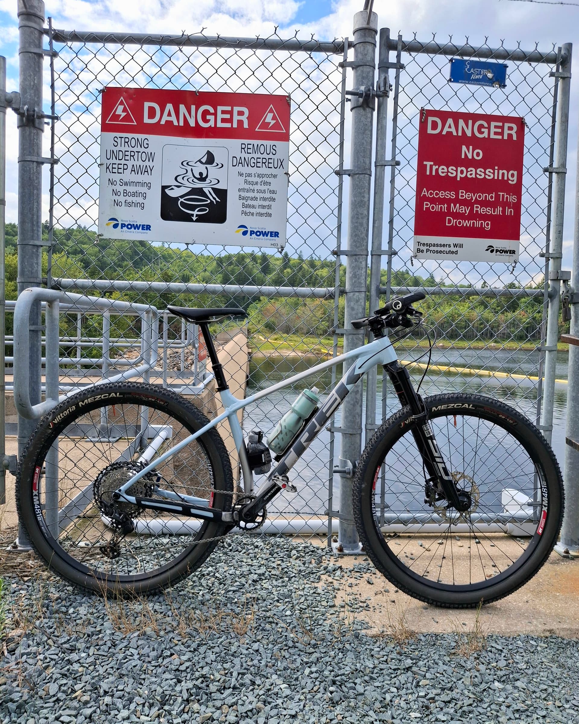

I bought a Procaliber alloy frame and built it with my parts.
You didn’t think about just adapting to the frame?
Nice, how does it ride?
