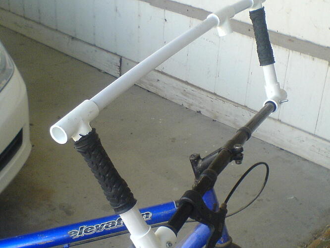

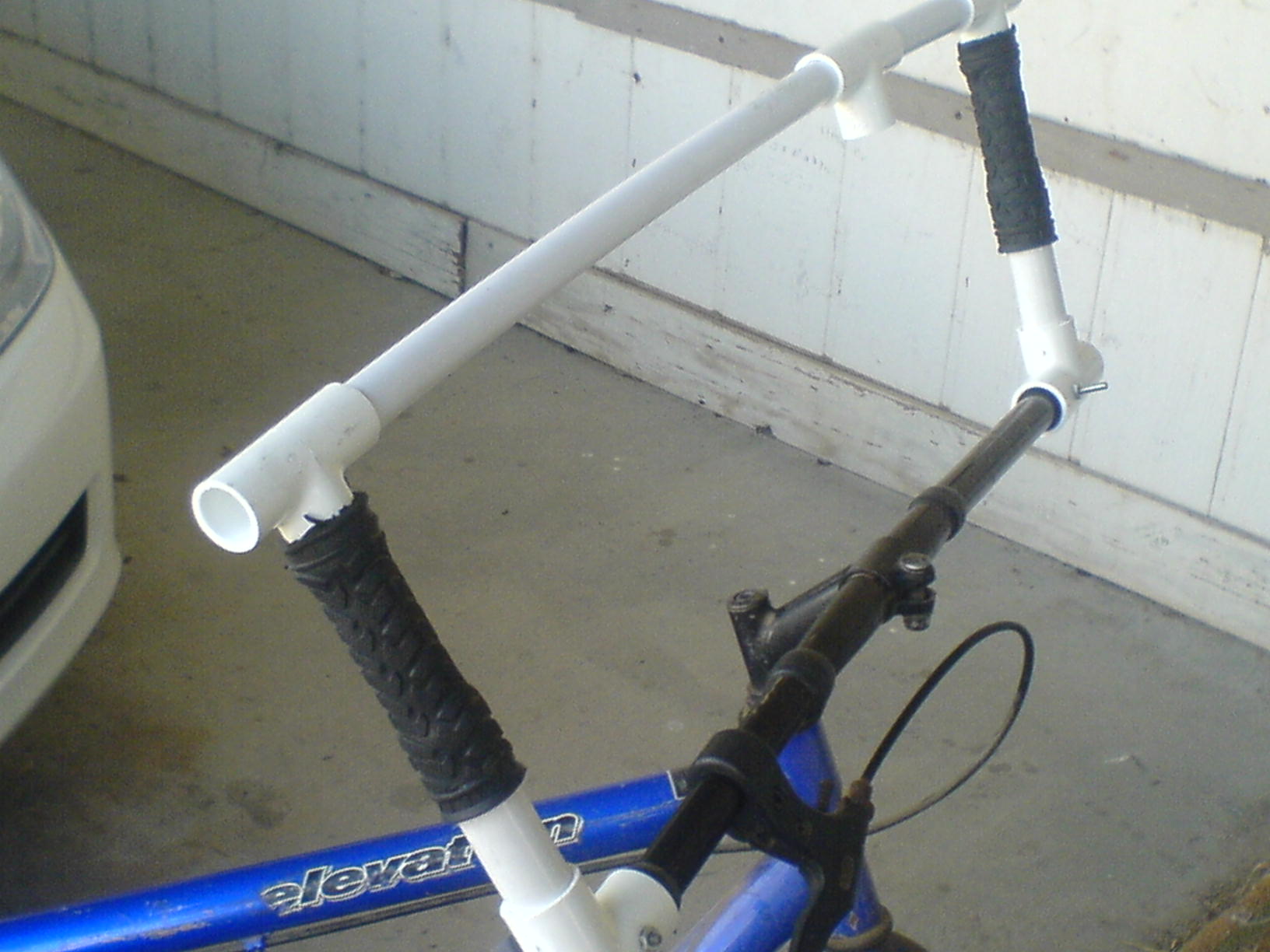

I run a copolymer 2 bar, 305mm riser. I’m told its too flashy, like I’m compensating for something, but it works.
