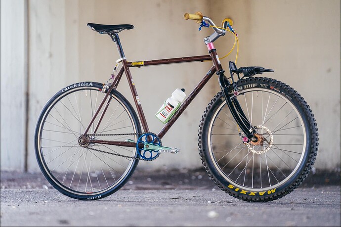

I’ve found sturdy tread with a soft compound makes for a good tire on the granite. If the compound is too hard it doesn’t grip well or if the lugs aren’t sturdy they’ll rip off easily. I’ve had good luck with tires from maxxis (dhr ii, dhr), schwalbe (nobby nic trailstar) and specialized (pergatory and butcher).
Strava users hate this one trick!
