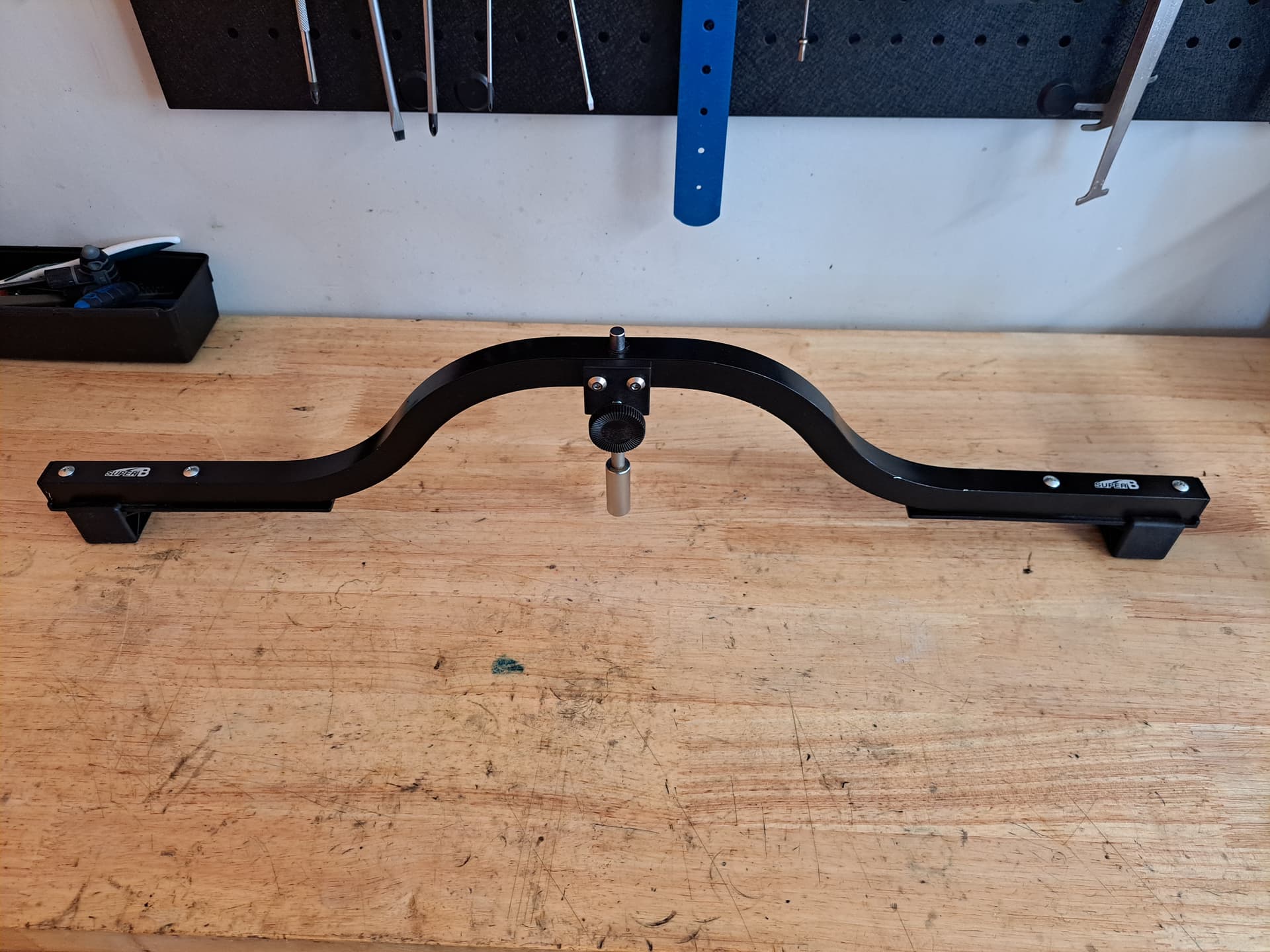

Everything Else
Another critical tool in wheel building is a dishing gauge. This is to determine the dish (centering) of the rim in relation to the spokes. Most bikes are built for a zero dish wheel, rim centered on the hub centerline. There’s exceptions to this rule, but those bike companies hate you. Some of my other tools are bladed spoke holders, a tire studding tool, and a deburring tool. Burrs from spoke hole drilling affect tensioning and truing. As a part of prepping the rim I check the spoke holes for burrs with a cotton swab. If burrs are present I clean them up with the deburring tool. The Rim Smith tool is great for removing minor dents and bends from rims and rotors. Also pictured is a Unior Hub Genie for removing hub end caps. I had three of them in 12mm, 15mm, and 20mm. The 12 and 15 broke pretty easily, the only reason the 20 hasn’t broken is because I haven’t used it yet. (Street Cents would say that they are fit for the pit!)
